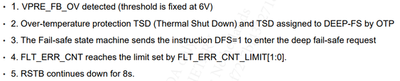

I have a test request where I need to frequently restart the MCU (Microcontroller Unit).
During the testing process, I observed that the PMIC (Power Management Integrated Circuit) FS84 entered the DEEP-FS mode. This may be due to frequent feeding of the Watchdog Timer (WD) trigger.
Issue Encountered:
When I restart the MCU, the PMIC does not restart. Therefore, I hope to restart the MCU by first restarting the PMIC.
Question:
However, I don't know how to restart the PMIC FS84 using an SPI (Serial Peripheral Interface) command.

Thank you to Tomas,
The FLT_ERR_CNT reached its limit due to an incorrect watchdog (WD) refresh. Here's how I plan to address it:
1.When the MCU starts, I will check if the PMIC has initialized. If it has, I will not feed the WD until a close window time. If the PMIC has not initialized, I will feed the WD immediately.
2.When I restart the MCU, I will check if the watchdog refresh time exceeds the close window. If it does, I will refresh the WD immediately.
3.By using this method, I will resolve the issue of incorrect WD refresh errors.

TomasVaverka
Here is a summary when the FS84 enters the DEEP-FS mode.
In your case I suppose that the FLT_ERR_CNT reached its limit due to incorrect WD refresh.
