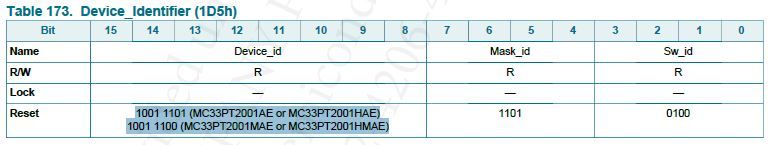

Hello Team,
In one of my project, I am using MC33PT2001AE IC and now we are replacing same IC with MC33PT2001HMAE, so I need few details like
1.what will be the software changes I need to do?
1 返信
1,638件の閲覧回数
TomasVaverka
Hello Snehal,
The “HM” version features the measurement function and end of injection detection.
If you do not touch the measurement function registers, there will be no impact on the software previously used (unless you check the Device_id which is slightly different as shown below).
