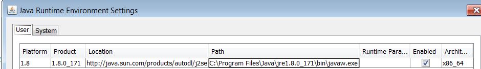

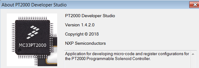

Hi all,
I am facing a similar problem for PT2000 DEveloper Studio
It shows below error
I have below Java Version
Please help me in this regard

b_tamkus
I had the same problem with the PT2000 Developer Studio, Version 1.3.7.0. After installing the 32bit version of java jre it works fine.
Kind regards,
Birgit
