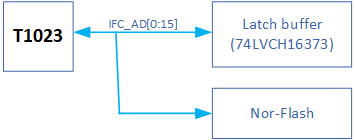

ufedor
Which exactly IFC_AD signals are low and which exactly IFC_AD signals are high when PORESET_B is low?
Which exactly "latch-buffer"?
Which exactly IFC_AD signals are connected to the "latch-buffer"?
5,037 Views

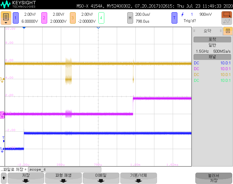

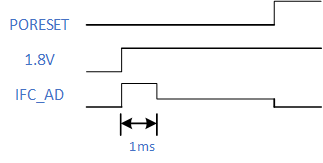

jaehwansun
The connection is as shown. (Removed FPGA)
What is unusual is the initial waveform and picture of IFC_AD.

ufedor
The latch buffer has bus hold which could affect the cfg_rcw_src signals levels.

jaehwansun
All signals work normally. (All requirements of T1023 datasheet, Table 1 are also met)
When PORESET goes high, RCW is read from nor-falsh, and when HRESET goes high, the last 8 bytes of RCW are read. After approximately 1.6 ms, ASLEEP goes low. But I can't proceed anymore here. (Sometimes it works normally.) If I go up after systemp up using Trace-32, the program works normally. Please let me know where to look.
