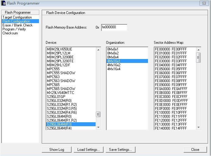

hello,
I am using Code Warrior to erase the flash of a board of MPC8379e. Unfortunately, I failed with the message of "get flash ID failed". But, I succeeded in another board of the same type. For the board with problems, almost all the relevant chips and signals were checked thoroughly with the findings that there were no signals to the pins related to flash during the process of erasing. What are the possible reasons? Can anyone help me please? Thanks!
Below is my flash configuration.
Below is the logs of CodeWarrior.

1) What is the NOR Flash complete part number?
2) How RCW is provided for the processor?
3) Have you checked the SDRAM to be operational by running default CodeWarrior project?

NOR flash part number : S29GL064A90TFIR3
RCW is provided by the default freescale BSP.
SDRAM is not operational by running default project.
I have using a digital scope to view all the signals connected to flash on operational and failing boards. There is not any signal output on the failing board. But, there are normal signals on the operational board.
How exactly the RCW is provided (applied) to the processor?
This explains the issue - operational SDRAM is required for normal Flash Programmer operation.

 The problem is resolved. One of the SDRAM chip is not properly soldered on the board. Thanks a lot.
