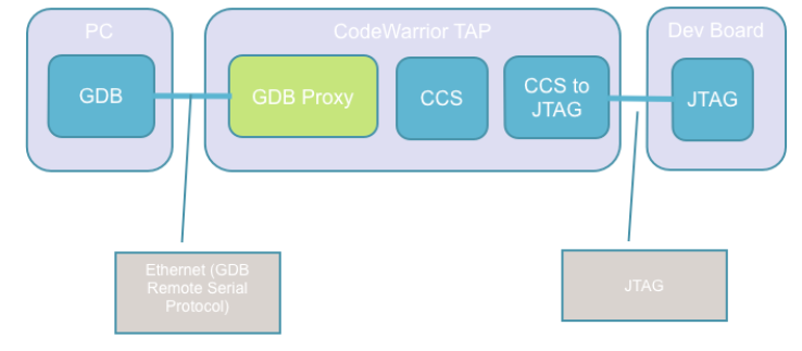

If you want to bring up your target with GDB, you also need to use CodeWarrior TAP, please refer to "GDB for Board Bringup 1.0 - Getting Started Guide" from  CodeWarrior TAP.

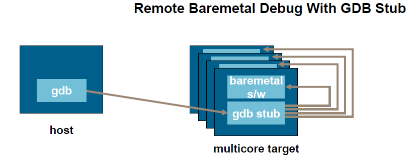

How about below picture in WBNR_FTF10_NET_F0676? What's the interface between host and target board? How do they connected?pastedImage_0.png
3,718 Views
yipingwang
You need to use CodeWarrior TAP to connect host PC and the target board.

wenlantang
As I know CodeWarrior TAP is a new product, before that there should be USB TAP between GDB PC and Target board? Should not? So this is a must?

wenlantang
Then what's the connection in the picture of WBNR_FTF10_NET_F0676 pasted above? The doc is on 2010 FTF when the CodeWarrior TAP is not introduced yet.
