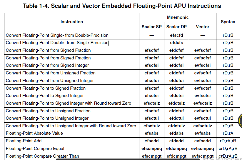

I want to look powerpc e500 Scalar and Vector Embedded Floating-Point APU Instructions implement , like evfscmpgt, evfscmplt instructions....E500CORERM.pdf just lists embedded floating-point instructions, but can't find the instructions implement document, who knowns how to download the document address? thanks very much ...

Please look "Signal Processing Engine (SPE) Programming Environments Manual: A Supplement to the EREF"
https://www.nxp.com/docs/en/reference-manual/SPEPEM.pdf
