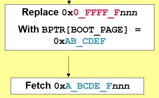

> 2. Set the BPTR at 0x00800000 (and enable page translation)
Please consider that in the P2020 QorIQ Integrated Processor Reference Manual, 4.4.4 Boot page translation register (Reset_BPTR) it is written:
"8–31
BOOT_PAGE
Translation for boot page. If enabled, the high order 24 bits of accesses to 0x0_FFFF_Fnnn are replaced with this value."
For the address 0x0_00800000 it is needed to set BPTR=0x80000800

ufedor
You wrote:
>  Indeed it still translates to 0xFFFFF000 -> 0xFFFFF000 for the entry 0.
And this is correct - refer to the P2020 QorIQ Integrated Processor Reference Manual, 4.3.3 Boot page translation.
BPTR (if enabled) works with real/physical address after MMU translation is performed.

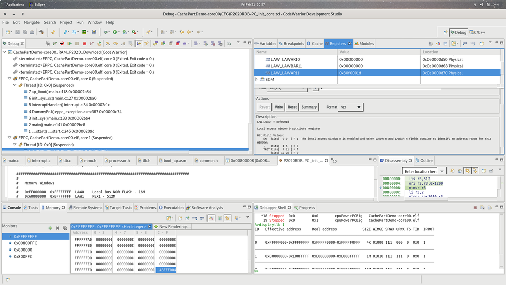

alexy_torres-au
Here is the screenshot, you can also find information about the LAW in the upper right corner.Screenshot from 2020-02-21 20-57-03.png
6,364 Views
ufedor
Please provide screenshot for the code at physical address 0x00800FFC.
6,364 Views
alexy_torres-au
Sorry I didnt see the address on the screenshot was 0xFFFFFFFC
Here is a screenshot at 0x00800FFC (physical):

ufedor
ba 0x800000
This is your problem.
You have to use relative addressing - not absolute.
6,364 Views
