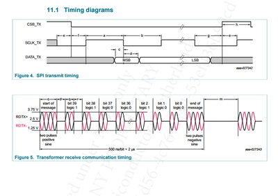

  I raised the en pin and could still see the validation of intb, However, when I sent data to mc33664, its tpl end remained at a high level all the time Both RDTX+ and RDTX- are 2.5v ,there is no level jump. What's the reason for this?
  I also want to know whether mc33664 can convert to tpl data regardless of whether the timing of spi meets the requirements.

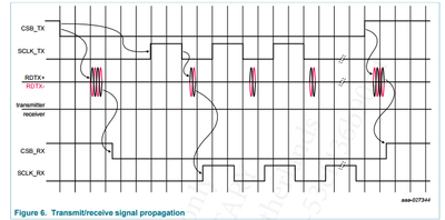

Can you catch some waveforms as below picture for visually  timing comparison ?
