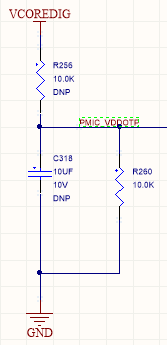

But my board (2/4) can't startup,and I added 400ms delay before POR.
The LDOs has no output  and  the clock(32K) did not oscillate.
i.MX6DL  and  MMPF0100F0AZES

I’m not sure if I’m properly understanding, but when you mention “my board (2/4) can't startup” you are saying that 2 of 4 of your boards are presenting this same issue? Please confirm, this could be important and could tell us that there are no problems with the design, but with the part itself (like a quality problem) or manufacture issue (like soldering profile).
You also mentioned “The LDOs has no output”, please confirm which LDO you are referring to.
It is also important to know the HW configuration of the VDDOTP pin, connecting the VDDOTP pin to VCOREDIG through a 100 kΩ resistor. And using this configuration, LDOs VGEN1 and VGEN 3 are disabled as you can see in Table 9 of the datasheet: https://www.nxp.com/docs/en/data-sheet/MMPF0100Z.pdf

“The LDOs has no output”——VDDARM_CAP 、VDDSOC_CAP、VDDHIGH_CAP,32K and 24Mhz can't start too!
the VDDOTP pin followed  evaluation board “MCIMX6DL-SDP”.

Quality problems are rare and typically affects more complete lots, this is why I asked to clarify your “my board (2/4) can't startup” comment, are you saying that 2 of 4 of your boards are presenting this same issue? Please confirm, this could be important and could tell us that there are no problems with the design, but with the part itself (like a quality problem) or manufacture issue (like soldering profile).
VCOREDIG hardware pin configuration is correct.
