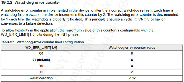

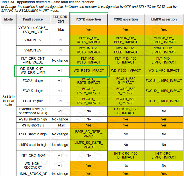

Each time the watchdog is not properly refreshed, the watchdog error counter is incremented by 2. When is reaches its configurable limit (6 by default), the fault error counter is incremented by 1 and the RSTB is asserted (WD_RSTB_IMPACT = 1 by default). This corresponds to 3 * 256ms = 768ms.
BRs, Tomas
