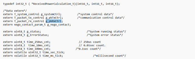

-5) does this solution support two-way proprietary package sending through Qi? This is a crucial point in our project, our power transmitters and receivers must be able to communicate with each other. There's qi_send_proprietary_packet in prx_lib.h, but how to do the reverse direction? How to receive proprietary packets? The sample code seems to do FSKDT operations and stores the received bytes, but how can I access the final packet in my application? Need to watch the extern T_packet_rx_control g_pkRxCtrl variable for incoming packets?

I'm glad I was able to help you by answering your question. Now about your last question
I haven't worked with that library, but while researching its use, I found that in WPR1500-HV Design Files you can find prx_lib.h, which contains the “external T_packet_rx_control g_pkRxCtrl;” that will help you with this part of the reception process.
Unfortunately, we don't have a practical example or documentation covering the use of g_pkRxCtrl.

Your application must:
  • Implement the Qi communication callback
  • Monitor g_pkRxCtrl.packet_ready
  • Read g_pkRxCtrl.payload[] once asserted
  • Clear the flag to re‑arm RX
You do not configure FSKDT directly for packet RX in normal operation—the library owns it.

Just one more question: in your answer to 5) you mentioned that the application must implement Qi communication callback; could you please pinpoint exactly which function you were thinking of? What I momentarily see is only that qi_communication_timer_isr() must be called with 250us period.

Meanwhile I was able to guess that g_pkRxCtrl is the key to reception. Just thought the supplied SW is complete and needs more work. To me this board is a bit uncommon and took some time to understand the concept, including the missing UART console, FreeMaster etc.
