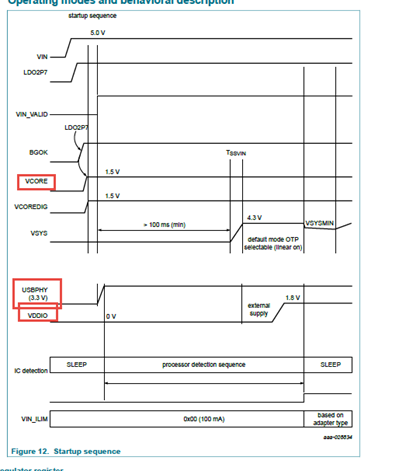

I have 2/30 boards with the PF1510 with the following symptom:
-> VCORE and VSYS do not come up.
I measure the following voltages on those boards:
VIN = 5V, LDO2P7 = 2.7V and VCOREDIG = 1.48V

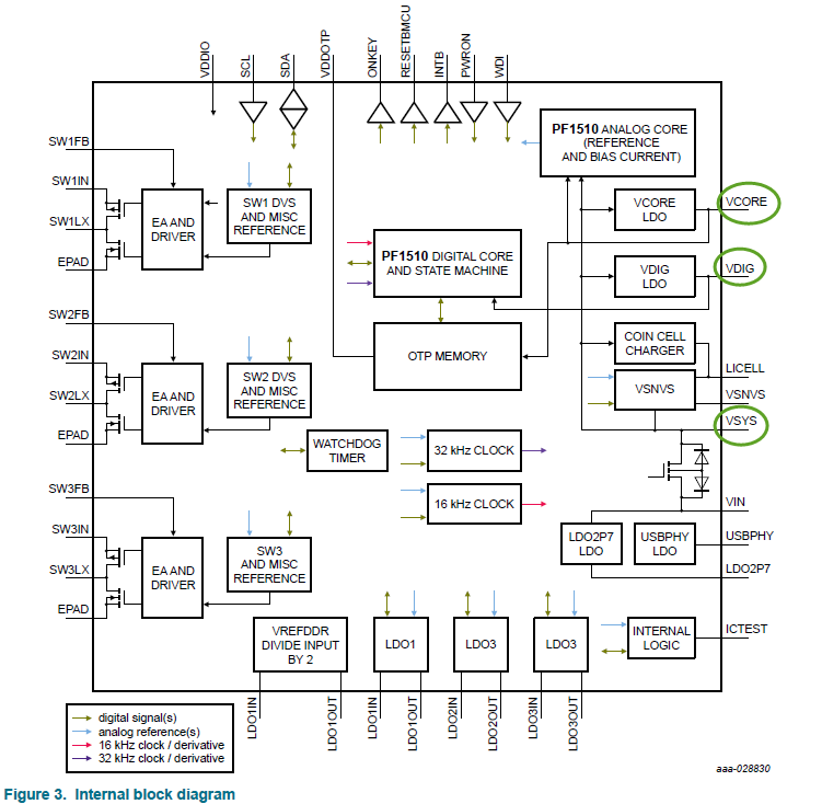

According to the above startup sequence, VCOREDIG and VCORE should come up before VYS. However, the Internal Block Diagram indicates that the VCORE and VDIG are derived from LDOs supplied by VSYS.
This implies that the VCORE and VDIG voltages should come up after VSYS.
Please help me understand the following:
1. What does the startup sequence indicate?
2. Why is the VCORE not coming up on the two defective boards? What is this symptomatic of? There is no obvious short circuit on any of these rails.
3. VIN_VALID is a register. What is BGOK?
Thanks for you help,
Ashwat Amirthalingam

1:Could you please test waveform about your VCORE and Vsys at start up sequence?
2: Please cross the bad and good board and the PMIC to test again.
3:BGOK means bandgap works well.
