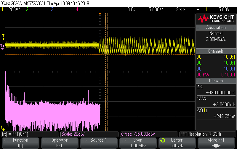

Each charger works fine individually, however when I use both chargers at the same time (both charger boards LED indicating an on-going power transfer) and then remove one from a receiver device, its LED stays on as if it was still attached to the device. The LED only goes off when I remove the second charger from the second device.
Since there is no other link except power (USB 5V & ground) from one charger board to the other, it looks to me like the charger that is not attached to the receiver interprets the messages sent from the other charger that is still attached to the second device as if it was for him.
Looking at the 5V line, I can see around 250mV of noise that I believe matches the communications of the other charger (frequency of the larger pulses is around 2 to 4 kHz):
Do you have any idea of what could be done to have two NXQ1TXH5 working together on the same power supply?

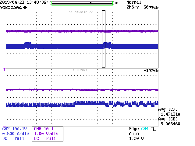

We would recommend to use a better power supply: a voltage source is supposed to keep the voltage constant regardless of the current that is drawn. If you have a 250mV ripple on a 5V supply, then this is 5% which is not a good voltage source.
With the NXQ1TXH5DB1401 demoboard connected to a USB adapter, there are Qi communication signals in the supply current, but not on the supply voltage:
