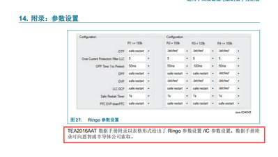

wandong
TEA2016AAT芯片手册,上面的RINGO软件附录介绍:TEA2016AAT 数据手册附录以表格形式给出了 Ringo 参数设置 /IC 参数设置。数据手册附录可向恩智浦半导体公司索取
能提供一下这个ringo的附录吗???
1 返信
249件の閲覧回数
TomasVaverka
Hi Dong,
Please refer to the Table 8 in the TEA2016AAT product data sheet (Rev. 1.3 — 12 January 2024): https://www.nxp.com/docs/en/data-sheet/TEA2016AAT.pdf
BRs, Tomas
