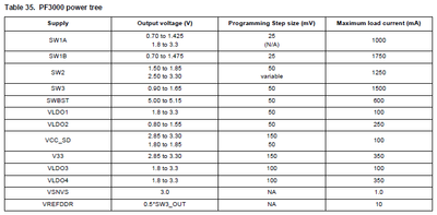

Do I understand the PF3000 datasheet right, that the SWBST 5V regulator needs 600mA of minimum load (Continuous load current I_SWBST, Table 13)? How is the light load behaviour? Don't see it properly specified in the datasheet.
All values for Table 13 are specified with I_SWBST=100mA, so this is in conflict with the 600mA min. current.
Also, is the Peak Current limit I_SWBSTLIM the max. continuous current or peak pulse current?
Could you please clarify?
- Minimum continuous load current for SWBST
- Light load behaviour
- Max continuous load current for SWBST
Thanks!

9,717 Views
philipp_blumberg
Thanks for your reply!
What is I_SWBSTLIM then in this context? This value DOES sound like a maximum continuous load current value
9,722 Views
philipp_blumberg
Thank you for your reply!
What is I_SWBSTLIM then in this context? This value from the datasheet DOES sound like max continuous load  corrent for SWBST
9,714 Views
JozefKozon
Dear Philipp,
the value I_SWBSTLIM is only a peak value for a very short time (us). The continuous current for the boost output is 600mA.
Please refer to the Table 35. in the datasheet. The maximum load current for SWBST is stated there 600mA.
With Best Regards,
Jozef
9,729 Views
JozefKozon
Dear Philipp,
the ISWBST values in the Table 13. are the guaranteed values. Meaning, that for the supply voltage at VIN pin from 2.8V to 3.0V it is guaranteed, that the PMIC is capable to provide minimally 500mA at the SWBST output and for the supply voltage at VIN pin from 3.0V to 4.5V, 600mA is guaranteed.
[A] 0A
- Light load behavior
[A] There is no issue in light load, however if any of the Bucks, Boosts or LDOs are not used, there is a recommendation how to connect the unused pins.
[A] Maximal continuous load current for SWBST are not stated. Only the minimal continuous currents are guaranteed. For 2.8 V ≤ VIN ≤ 3.0 V it is 500mA and for 3.0 V ≤ VIN ≤ 4.5 V it is 600mA.
With Best Regards,
Jozef
9,725 Views
JozefKozon
Dear Philipp,
Just to avoid misunderstanding. The maximum continuous load current for SWBST is not stated, but it is probably only slightly higher, than the minimum continuous load current.
With Best Regards,
