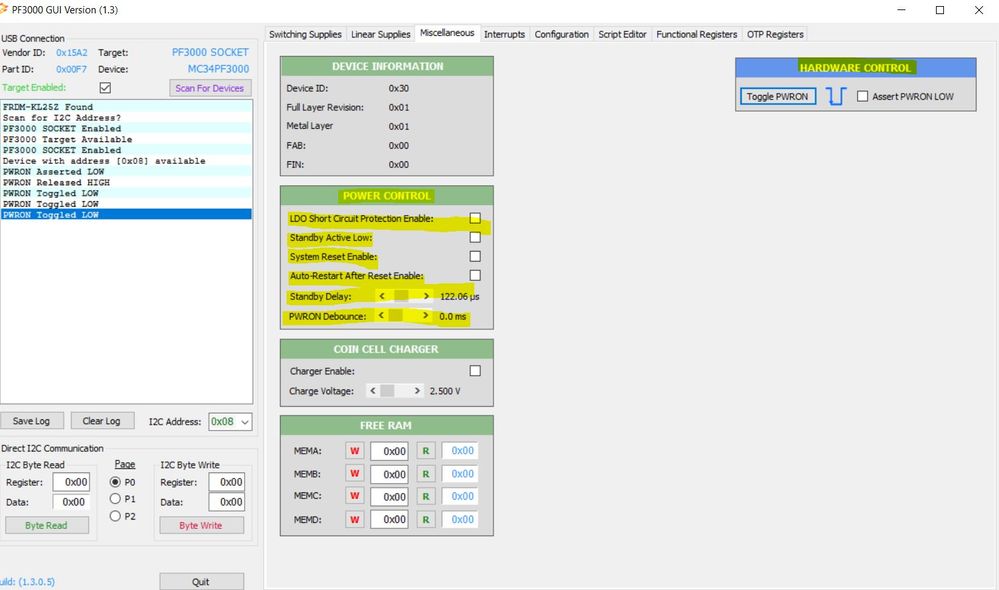

Hi, I am able to program the device and see the output. I had got the voltae drop across MOSFET. Actually, PMIC should get 3V at PWR_ON pin, then only we will get the 4.5V after the MOSFET.
Also, do you have further more information regarding options in the GUI. As I can see some functions like power control(as highlighted in the picture). May I know the functionality of those.?
I am searching for an option where the status of the PWR_ON pin does not affect the switcher and LDO output voltages, can it be programmed ?

From the Power Control Settings:
“LDO Short Circuit Protection Enable” turns ON the REGSCPEN bit. Whenever a current limit event occurs on a LDO regulator, this regulator is shutdown.
“Standby Active Low”, turns On the STANDBYINV bit, STANDBYINV is used to control the polarity of the STANDBY pin.
“System Reset Enable”, turn on the PWRONRSTEN bit, when set to 1, the PF3000 can enter OFF mode when the PWRON pin is held low for 4 seconds or longer.
“Auto Restart after Reset Enable” turns on the RESTARTEN bit, When set to 1, the PF3000 restarts automatically after a power off event generated by the PWRON (held low for 4 seconds or longer) when PWR_CFG bit = 1.
You can try to toggle the PWRON button using the “Toggle PWRON button” to initiate the startup and check if this works.
PWRON should be powered with 3.3V  for normal work, this is typically true all the time when USB is connected.
