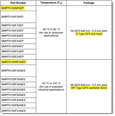

Hi, can someone please point to the distributor having this component available in stock at the moment. I am looking for non-programed OTP version, what is the part number, is it MMPF0100NPAEP ?

Hi, I can consider but how about the footprints on PCB layout of MMPF0100NPANES and MMPF0100NPAEP. Are they same ?

Hello John,
Both devices are 56 QFN 8X8 and they share the same pinout.
Please be aware that the only difference is the wettable flank vs full lead.
Please find more details at chapter 8 from the datasheet.
I hope this information helps.
David

Hello John,
I hope all is great with you.
I am afraid that we are really not able to retrieve nor provide information about part availability across our partner network.
Please accept my apologies for any inconvenience.
Have you considered the MMPF0100NPANES device?
