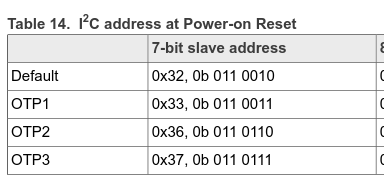

What is the I2C address for MPF9453AVMA2HN? And what for MPF9453AVMA1HN?
The datasheet is not clear on this regard.
There is this table
however I was not able to find how to relate OTP1, OTP2, OTP3 and Default with the actual part number.

Hello Francesco,
For both the MPF9453AVMA2HN and MPF9453AVMA1HN, the 7-bit I2C address is 0x32 (default).
