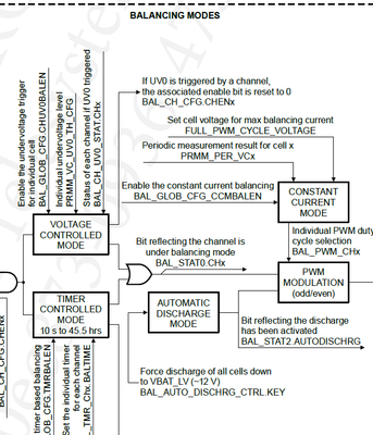

As per the NDA MC33774AESP1AE datasheet
1.Is it possible to combine constant current mode with other balancing modes? If yes, does BAL_STAT0.CHx (the bit reflecting that the channel is under balancing mode) affect constant current balancing? If no, what is the stop condition for constant current balancing?

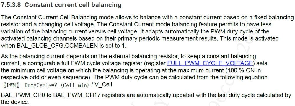

2. What is the value of VCellmin, VCell in PWMDUTYCYCLE=VCellmin/ VCell.?
[A] Please refer to the AN14084. The balancing modes are very well described there. The balancing modes can be combined. E.g. the Voltage-controlled balancing and Temperature-controlled balancing. Please download the AN14084 from the MC33774A product page, under the secure files.
Could you please direct me to the formula you are referring to? So far I couldn't find it in available documents.

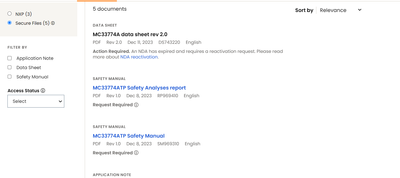

1.In the product path below, I am able to find only 5 secure files, and the AN14084 document is not there.
https://www.nxp.com/products/power-management/battery-management/battery-cell-controllers/18-channel...
2.Regarding the formula, it is in the constant current balancing section of the MC33774A datasheet.

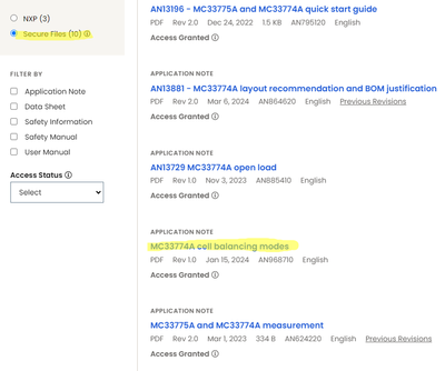

Dear Mohana,
you need to ask for a higher access. My colleague supported your colleague via chat.
The minimum Cell voltage for the MC33774A is 2.0V. Below this, the UV is triggered.
