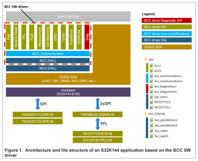

You can download this software drive example which include :
Embedded SW: MC33771C/MC33772C SW Driver | NXP Semiconductors
