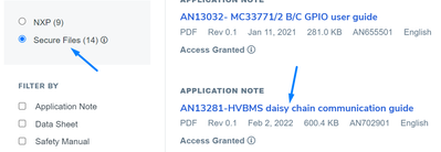

I have found a case, where another customer has similar issue. But the customer is using more MC33771C nodes. I guess you have only one MC33771C node connected to the MC33664? Still please see the answer below. Have you changed the CID value in your MC33771C?
You can download the AN13281 from the MC33771C product page, under the secure files.
DESCRIPTION
For initialization sequence of a daisy chain, I suggest to get the AN13281-HVBMS daisy chain communication guide and apply  the TPL2 initialization sequence.
About the CSB_RX staying at low level: it can be due to the collision of two messages coming from two MC33771C having the same CID. The falling edge of the CSB_RX is the consequence of a SOM pulse on the TPL line; end the rising edge the consequence of a EOM pulse. During the simultaneous communication, the EOM on the TPL line can be corrupted and not interpreted by the MC33664. In this case the CSB_RX stays at a low level.
