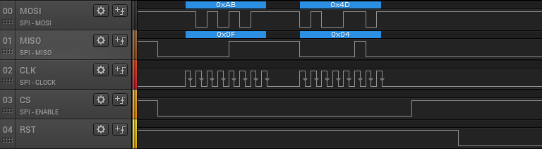

   When I using SBC FS4500, I try to verify whether the state machine swich of NORMAL MODE ->LPOFF-Auto WU->Wake-up is really worked. When in Normal mode, I sent spi by writing Mode register with LPOFF_AUTO_WU as 1 to SBC; then I watched the waveforms about the reset pin and vpre pin of SBC by oscilloscope, but it didn't happen such as from high level to low level. So I wonder to know if there are any ways to confirm the state machine switch is really worked.

Which command/sequence are you using to enter the LPOFF mode? Do you have a logic analyzer or an oscilloscope to double check the correct command was sent?

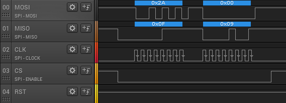

The bit LPOFF in the Mode register indicates if the device resumes from LPOFF-sleep or LPOFF_AUTO_WU mode:
The corresponding 16-bit read command is 0x2A00.

Thanks for your kindly advice. In my environment, I send command to set Mode register  GO_LPOFF bit as 1, and wakeup it by give IO_0 a rising edge and it really happend LPOFF as 1 which you mentioned above. However, when I send command to set Mode register LPOFF_AUTO_WU bit as 1, and do nothing, just watching whether it can happend that LPOFF is 1. Unfortunately, it doesn't work.

The write command I use to set the device in LPOFF_AUTO_WU is 0xAB4D:
As you can notice, the RST pin is properly asserted low.
Then when I read the Mode register (0x2A00) I get:
... which indicates the device is back in the INIT mode resuming from LPOFF_AUTO_WU mode.
Are you using the same commands? Can you please post here your measurements?

Thank you very much, I checked my code, and found that when I send command to set SBC in LPOFF_AUTO_WU, there will send command to set SBC in GO_LPOFF as well due to my code has some bug. When I fix it, it's OK.
