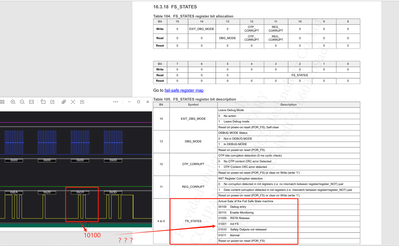

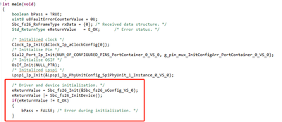

Fs26 使用函数 Sbc_fs26_initDevice() 初始化失败,导致寄存器 FS_STATES 数据读取异常。读取的数据为 0x14 (10100)。这是什么原因呢?谢谢

please refer to the Figure 15. in the FS26 full datasheet for application flowchart. You need to send one good watchdog refresh to the FS26 from your MCU before 256ms timeout. Please refer to the section 20.4.

xihao_he
hi,Jozef
But I have already enabled the DEBUG pin, do I still need to do this? And I have seen the example provided by S32DS, which simply calls this function without noticing any operation of feeding the watchdog inserted in between? Please take a look at my latest screenshot, thanks

Dear Xihao,
unfortunately yes. Even if you have applied 2.5 V < VDEBUG < 6V to the Debug pin for debug mode entry you still need one good watchdog refresh within the 256ms to close the INIT_FS. Please refer to the Figure 77. Debug mode flowchart until safety outputs release in the FS26 full datasheet.
If you will set the window duration to infinity in the INIT_FS, then no more watchdog is required during debug mode. But to close INIT_FS you need one good watchdog refresh within the 256ms. No matter of the voltage on the DEBUG pin.
