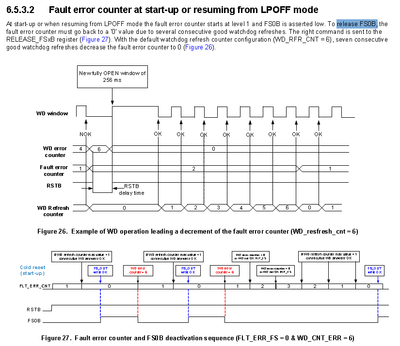

Now we are using S32K324&FS6513 for our ECU, but the FS0B of FS6513 is always low although we have invoke the release function. and I have checked below condition.
read the corresponding register:
寄存器                                           读取的值
DIAG_SF_ERR                                0xF00
SF_OUTPUT_REQUEST                  0xF81
BIST                                               0xF0F
any idea from your side?

我没办法粘贴图片,从normal 状态转换到release FSXB 需要满足下面的的条件:
1:FLT_err_count=0
2:ABISTx ok
3:FS_OUT ok
你这个背景是第一次release FSXB还是说遇到了fault以后FSXB拉低了然后你想把他置高?

1:FLT_err_count=0
2:ABISTx ok
3:FS_OUT ok
这些状态都对吗?上面的这些状态?
7,122 Views
witness248
1:FLT_err_count=0
这个count,只在第一次喂狗前,为0,后续都是不为0。所以我的release FS0B只能被调用一次(放到了喂狗函数里)。
2:ABISTx ok
这个是OK的
3:FS_OUT ok
怎么判断OK?是通过读取RELEASE_FSxB吗?

1:你好像是有fault一直,所以faulterrorcounter不是0.
2:the "FS_OUT write OK" means, that the right command was sent to the RELEASE_FSxB register. If the right command was sent there by the MCU, the FS0B is released. Same for the FS1B if the FS6500 have this pin.

你好,如下条件需要满足
•ABIST2_FS1B_OK=1 if part number with FS1B
•ABIST2_VAUX_OK=1 except if VAUX_FS_OV_1:0=VAUX_FS_UV_1:0=”00”
•Fault is removed
•Fault error counter must be at ’0’
•Close the S1 switch if FS1B backup delay was engaged (FS1B_DLY_DRV bit = 1)
•RELEASE_FSxB register must be filled with the right value
6,600 Views

1) 首先BIST中的ABIST2_VAUX_OK一直都是错的,这个需要排查下,我的BIST_ADR配置的是0x65.
2) 我是在喂狗函数里,读取DIAG_SF_ERR,当FLT_ERR_2:0为0时,再去释放FS0B。每连续7次喂狗,错误count会递减。
