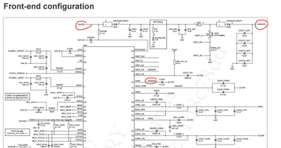

we design Motor Controller using S32K311 Microcontroller With FS26 PMIC,
We config FS 26 PMIC as Direct Voltage from Battery voltage to VSUP pin. we don't used VBST connection so VBST_FB, VBST_ISL, VBST_ISH connected to GND as per datasheets.
Now only we get voltage VDIG =1.5V, VBOS =5.0V, VPRE =0V
what we do to get VPRE voltage ???

MFS2613AMD3D and MFS2613AMD6D
2,990件の閲覧回数
guoweisun
MFS2613AMDA3AD and MFS2613AMDA6AD,right? If yes they are frond-end configuration you need refer to below circuit:

GNANAPANDI
if this PMIC , will it support direct power supply to VSUP without Front end mode (without VBST) configuration

guoweisun
No,for these two parts had done OTP with the frond-end model which doesn't support this.
