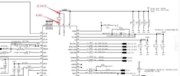

The upcoming mass production project encountered the following issues when using FS2322:

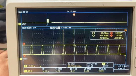

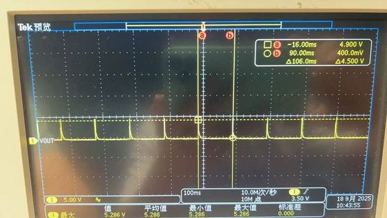

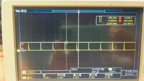

V1 output is abnormal as below waveform:

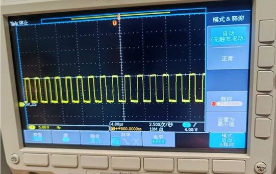

By observing the waveform of the two terminals of the bootstrap capacitor, it was found that the waveform was abnormal。
Abnormal waveform at both ends of FS23 bootstrap capacitor:

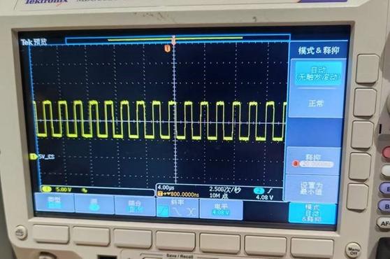

The normal FS23 output bootstrap capacitor has a square wave with an amplitude of 10V at both ends:
After trying to replace the bootstrap capacitor with the same capacitance value, the problem disappeared. Currently, the selected capacitor specifications are as follows:
33nF_10%_50V_0603_X7R_Murata
My current question is, are there any special requirements for the selection of bootstrap capacitors? How can I thoroughly solve the problems I am currently facing?
PS: This issue occurred during mass production, excluding capacitor damage. Currently, 3 cases of this problem have been found.
