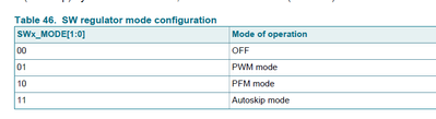

EP CONFIGURATION OF PF8100
2,129件の閲覧回数
Ellu24
In EP configuration of PF8100, switch3,4,5 are off /disabled. What does it mean? Can I program these switches as per my desired voltages ? Please explain me its details.Please find attachment.
Thanks in advance
Elizabeth
1 返信
2,122件の閲覧回数
guoweisun
You can operate register to turn on them by IIC after PMIC startup.
