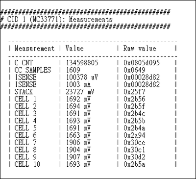

We are using "sw499711 MC33771BMC33772B-Battery-Cell-Controllers"  for "Monitoring_Diagnostics Examples".
We are observing log for this output like image below.
Multimeter (1.01A) and MC33771 (ISENSE : 1003mA) is consistency, but i am getting Coulomb Count measurement result as 134598805.
What is the relationship between COULOMB_CNT with ISENSE?
How to calculate values?
Average Isense = COULOMB_CNT *  V2RES / CC_NB_SAMPLES / RSHUNT !!!

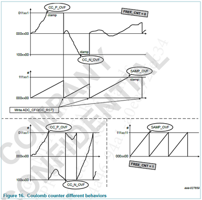

please check if the FAULT pin is activated. The coulomb count value is impacted if the overflow occurs. I suspect this is the reason for incorrect current result.
In the event an overflow occurs in either COULOMB_CNT or CC_NB_SAMPLES, the
CC_OVR_FLT bit is set and, when unmasked, the FAULT pin is activated. The coulomb
count value is impacted by conversions performed during diagnosis of the current
measurement chain.
The COULOMB_CNT is an integer whose associated resolution is V2RES, therefore,
COULOMB_CNT·V2RES gives μV. If the shunt resistance RSHUNT is expressed in μΩ,
then COULOMB_CNT·V2RES / RSHUNT gives μA.
