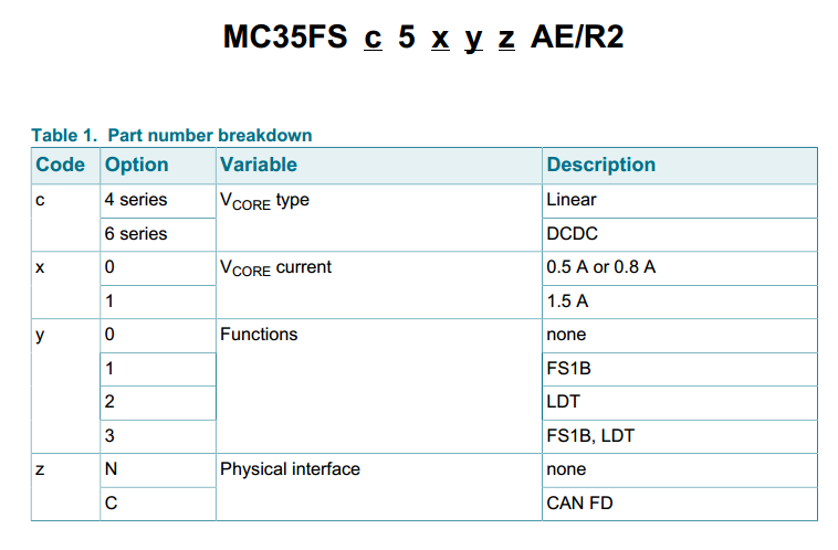

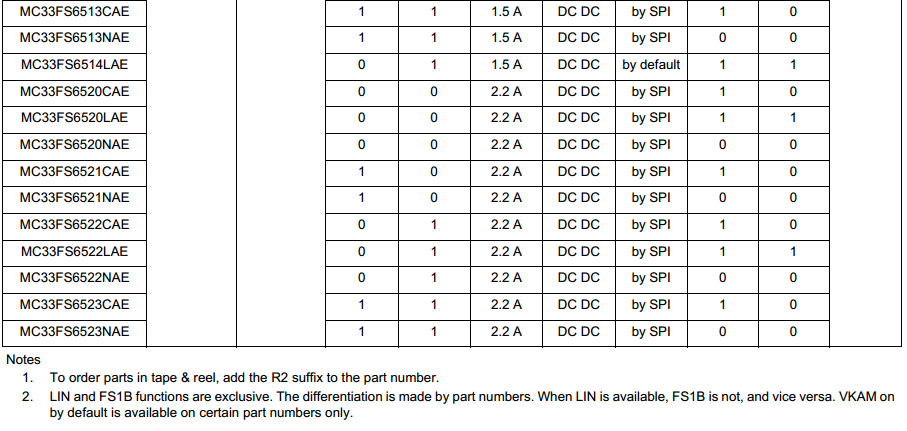

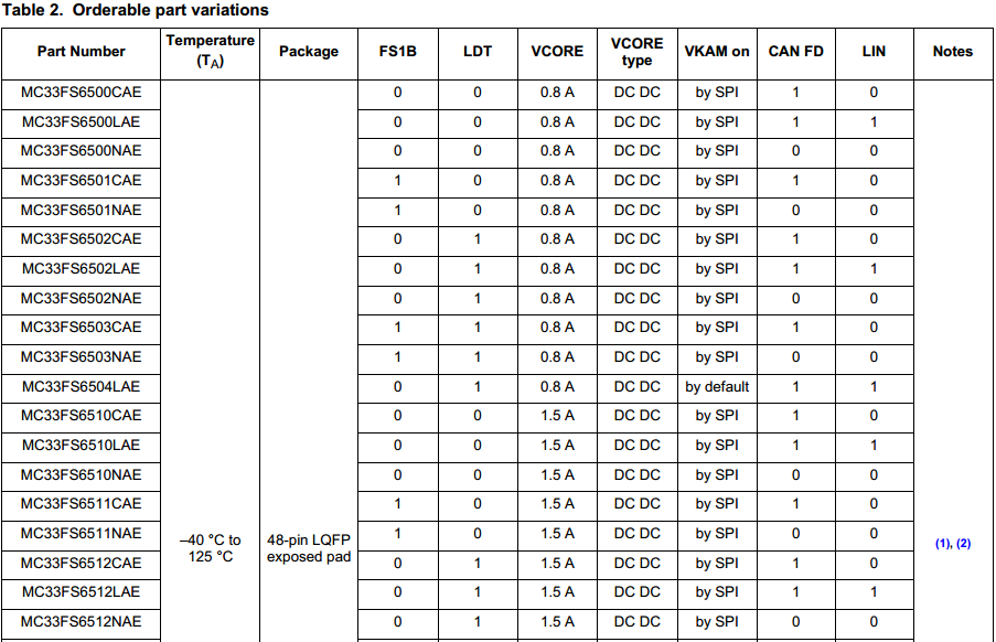

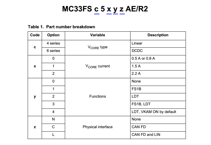

There are many members in the family of FS45&FS65, which you can choose the best for your application, you can see the rules of number definition and check the difference of different members from the picture below:
More detailed, refer to :https://www.nxp.com/products/power-management/system-basis-chips/functional-safety-sbcs/grade-1-and-...
