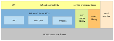

2. Software Architecture

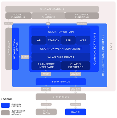

3. Clarinox WiFi Stack
  • The ClarinoxWiFi Protocol Stack is a comprehensive solution across a large range of RTOS/MCU – including WPA2/WPA3 personal and WPA Enterprise certificate based security options on RTOS/MCU.
  • Key features
    -Supports 2.4GHz and 5GHz bands
    -Supports multiple simultaneous roles
    -Isolation of application from lower layers
    -Modular architecture: many OS/RTOS and TCP/IP stack
    -Enables single and multi-threaded applications
    -Support for blocking and non-blocking API calls
    -Built-in protocol analysis tool
    -Suitable for a range of embedded applications such as infotainment, navigation, video streaming, data transfer and healthcare devices
    -Implementation covers security architecture, SoftAP and supplicant
