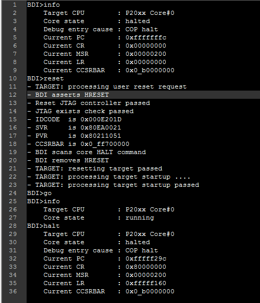

Hi, I am porting u-boot from P2020RDB code base to one of my custom board based on P2020 processor. As u-boot boots from 0xfffffffc, it is getting stuck at infinite_debug_loop: in start.S, I am not familiar with PPC assembly ISA, please help me to debug the fix the issue.

sinanakman
Senior Contributor III
Hi Venkat
With your BDI, if you like to not execute your init script you would
need to issue a RESET RUN. Please try this when you reset.
You mentioned that even without BDI you don't see any output
but this might be a separate problem. To ensure your init section
is not executed as Platon suggests use RESET RUN and see what
happens with CCSRBAR. BTW, which config file you are using ?
Sinan Akman

venkatt
Hi Sinan,
  Thanks for point me to config file, yes after tweaking config file I could able to avoid the infinite_debug_loop.
Then somewhere down the line, it was not able to access the stack set-up under init_ram, in my case its at oxffd0_0000, which I mapped to L2SRAM via config file then all function call were fine.
Now I got stuck at function "cpu_init_early_f ", basically control is not coming out of this function, because LR is re-loading with wrong value at the end of this routine, but while entering the routine the LR was right. so to skip I forced the LR to "cpu_init_early_f + 0x04" . but after reaching here target is getting freezed.

venkatt
Hi All,
I am able to boot u-boot on my board with BDI connected, i.e 'reset halt' and 'go'  will bring the board up.
But as I try to boot the board independently i.e without bdi connected I dont see any output on console.
still u-boot is missing something that BDI config does if so please help to find that missing stuff.
Thanks a lot
venkat

bpe
u-Boot enters infinite_debug_loop if it discovers that CCSRBAR is not
at the location it expects. start.S has a comment about that a few lines
above the loop. If you are working with a JTAG debugger, make sure
it executes no startup script which alters CCSRBAR before u-Boot
gets control.
Platon

venkatt
Hi Platon,
 Thanks for info,
when you say CCSRBAR is not at the location it expects means, do it expects it to be at default location i.e 0xff700000 ?
I use bdi jtag debugger, after flashing u-boot as I run below commands
BDI> reset
BDI> go
I don't think the script executes with those commands
as-well  when I saw below info when core is at halted state and PC points to reset-vector address CCSRBAR ( line # 9) has other than default value - IS THIS THE CONCERN

venkatt
sorry I pressed ctrl+s before completion,
at line #10 I did reset then after CCSRBAR is at default location,
then go and info shows that PC is stuck at 0xffff_f29c which is the infinite_debug_loop address, as per System.map file.
Even I tried with BDI disconnected from target and did a powercycle but I dont see anything on the console ( both for 9600 and 115200 baud rate )
Please help.
