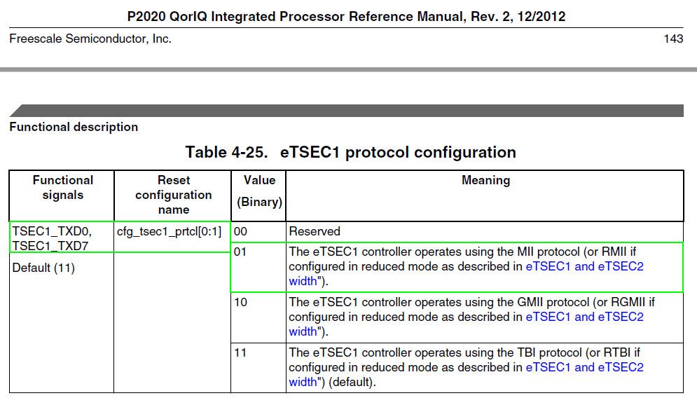

i want to set the eTSEC1 at POR to act at MII mode ,
according to Table 3-2 at the P2020RM the cfg_tsec1_prtcl[0,1] are TSEC1_TXD[0,7] signals respectively.
according to Table 4-19 in order to work as MII the POR values should be :
cfg_tsec_reduce = 1 , and cfg_tsec1_prtcl = 01.
it is not clear to me
does that mean cfg_tsec1_prtcl = TSEC1_TXD[0,7] = 01 ?
i would expect the notion to be cfg_tsec1_prtcl[0:1] = 01
