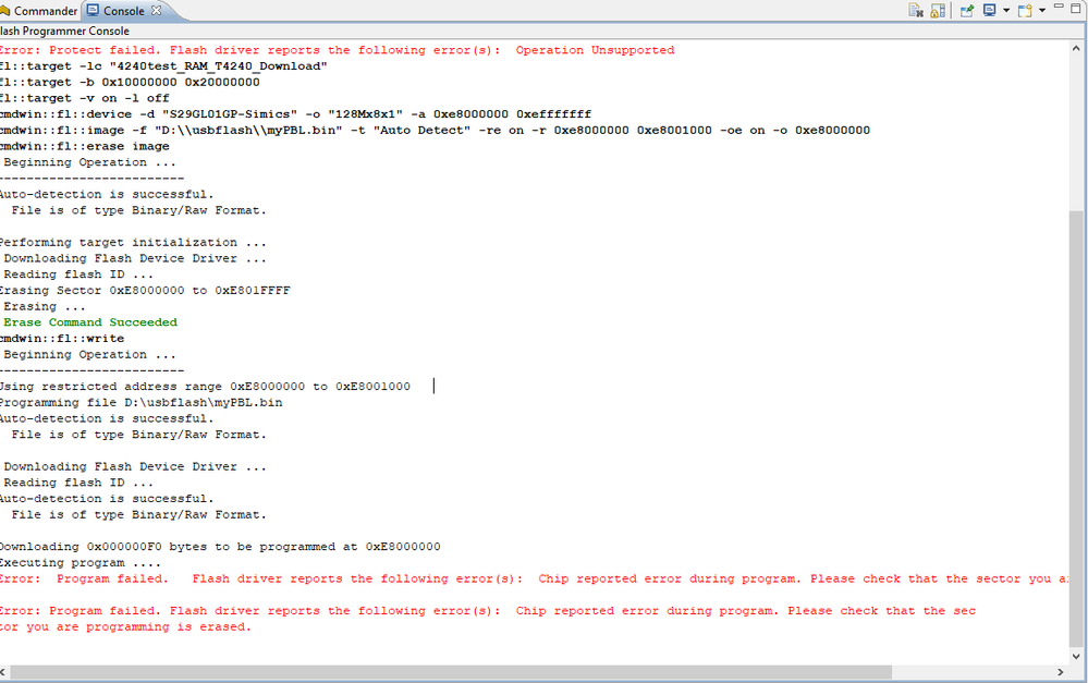

   I tried to program nor flash on a t4240qds bareboard via CodeWarrior TAP, but got following error.
   I added an unprotect , an erase  and a program action. I'm sure the qds board is good.
fl::target -lc "test_RAM_T4240_Download"
fl::target -b 0x0 0x180000
fl::target -v off -l off
cmdwin::fl::device -d "S29GL01GP" -o "64Mx16x1" -a 0xe8000000 0xefffffff
cmdwin::fl::protect all off
Beginning Operation ...
Performing target initialization ...
Downloading Flash Diagnostics Driver ...
Reading flash ID ...
Unprotecting all sectors...
Unprotecting ...
Unprotecting ....
Unprotecting .....
Unprotecting ......
Unprotect Command Succeeded
cmdwin::fl::device -sd all
cmdwin::fl::device -se 0
cmdwin::fl::erase list
Downloading Flash Device Driver ...
Erasing Sector 0xE8000000 to 0xE801FFFF
Erasing ...
Error:  Erase failed.   Flash driver reports the following error(s):  Sector Protection Error
Any help will be appreciated.

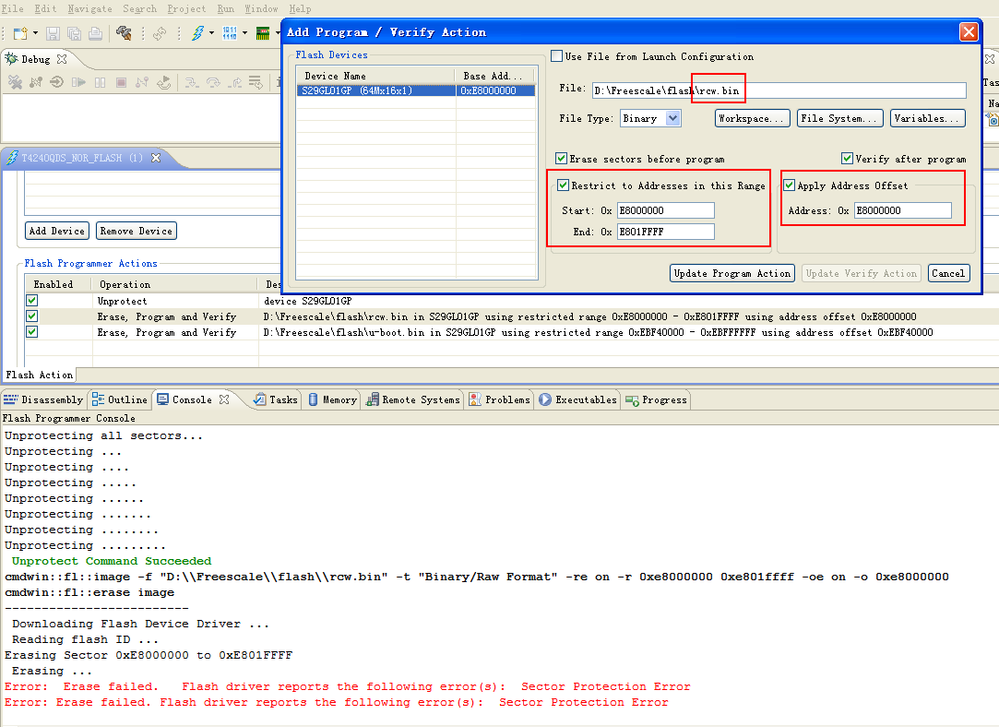

Instead of adding Erase action for sector, you must use Program Action with Erase sectors before program.
Adrian
7,361 Views
p4080ds
Hi Adrian,
  Thank you for your patience to answer.
   I also tried the way which you metioned above, but still show me Sector Protection Error.This is very confusing. Is there any other helpful tips I missed?
    Weiqiang
7,361 Views
addiyi
Did you check 'Restricted Addresses in this Range' option? Also, make sure you use the init when connecting to board.
Adrian
7,361 Views
p4080ds
Yes, I checked this option.
7,361 Views
addiyi
This option will restrict actions on that memory zone. You don't have to use this option, just use Erase before programming and eventually the Address Offset.
