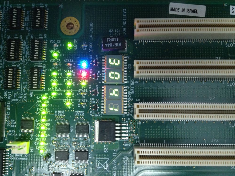

t_alex
I have P3041 board (in tower encasing) but when I power on the led D5 is red.
Is it possible something is wrong with the ngPixis chip?
Anybody encountered similar issue?
6 Replies
2,903 Views
t_alex
see the photo showing all the leds state. Hope it can give you some clue.

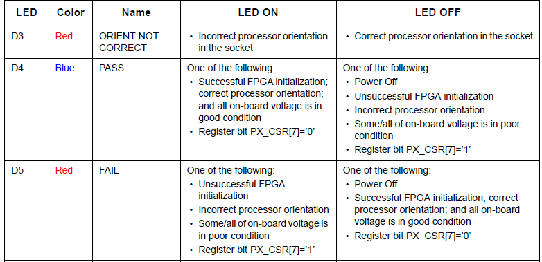

lunminliang
This is copied from P3041DS document.

t_alex
It seems for my board PX_CSR[7] ='1'
What does that mean? The FPGA reports FAIL condition?

lunminliang
Just means D5 is lighted according to the document.
Is there any other abnormal phenomenon?
