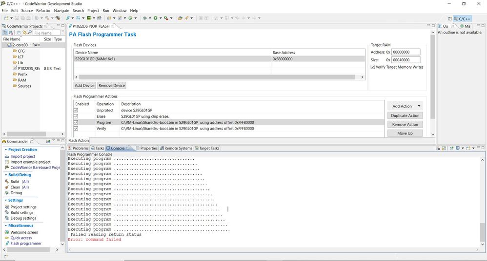

I am using p1022 device and I use the option flash file to target from codewarrior IDE.
Have a look at the error what we are getting in the attached image.

The simplest way is the following:
Create a CodeWarrior Bareboard Project. See the ClipBoard04.jpg file.
Test your connection using this project. Load a simple code using this project.
Set "Run Configuration" in Flash programmer to this project.
See attached Clipboard02.jpg.file.

Thanks PavelChubakov, I am able to proceed little more.
But facing issues at the last step.
Please have a look at the attached error.
Console Log
fl::target -lc "2-core00_RAM_P1022_Download"
fl::target -b 0x0 0x40000
fl::target -v on -l off
cmdwin::fl::device -d "S29GL01GP" -o "64Mx16x1" -a 0xf8000000 0xffffffff
cmdwin::fl::protect all off
Beginning Operation ...
Performing target initialization ...
Downloading Flash Diagnostics Driver ...
Reading flash ID ...
Unprotecting all sectors...
Unprotecting ...
Unprotect Command Succeeded
cmdwin::fl::erase all
Downloading Flash Device Driver ...
Erasing entire flash ...
Erasing ...
Erase Command Succeeded
cmdwin::fl::image -f "C:\\VM-Linux\\Shared\\u-boot.bin" -t "Binary/Raw Format" -re off -oe on -o 0xfff80000
cmdwin::fl::write
Programming file C:\VM-Linux\Shared\u-boot.bin
Downloading 0x00010000 bytes to be programmed at 0xFFF80000
Downloading 0x00010000 bytes to be programmed at 0xFFF90000
Downloading 0x00010000 bytes to be programmed at 0xFFFA0000
Executing program ....
Executing program .....
Executing program ......
Executing program .......
Executing program ........
Executing program .........
Executing program ..........
Executing program ...........
Executing program ............
Executing program .............
Executing program ..............
Executing program ...............
Executing program ................
Executing program .................
Executing program ..................
Executing program ...................
Executing program ....................
Executing program .....................
Executing program ......................
Executing program .......................
Executing program ........................
Executing program .........................
Executing program ..........................
Executing program ...........................
Executing program ............................
Executing program .............................
Executing program ..............................
Executing program ...............................
Executing program ................................
Executing program .................................
Executing program ..................................
Executing program ...................................
Executing program ....................................
Executing program .....................................
Executing program ......................................
Executing program .......................................
Executing program ........................................
Executing program .........................................
Executing program ..........................................
Executing program ...........................................
Executing program ............................................
Executing program .............................................
Executing program ..............................................
Failed reading return status
Error: command failed

aswinas017
Issue resolved using direct flash file to target utility.
