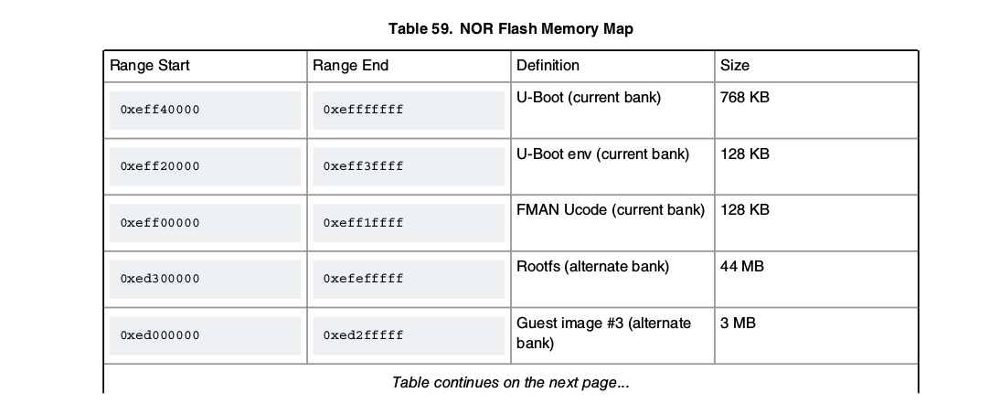

We are using P2040 in our board. We are using QorIQ SDK V2.0 along with update
SDK-v2.0-1703 .
In QorIQ SDK v2.0-1703 Documentation in Table 59. NOR Flash Memory Map is Given .
How to customise this memory map if we want to use root file system with more than 44MB size
3,166 Views
karavindvijayak
Is there any place in the code or compile environment where I have to make the changes for enlarging the rootfs from  0xe9300000  -  0xebefffff  to  0xe8900000 - 0xebefffff .
We have directly connected the msb ( A25 pin ) pin of flash to processor address, LA5 .  Which means we will not have alternate bank concept in our design.
In this case can we enlarge our rootfs from 0xe8900000 to 0xefefffff ..?

Hello k aravind vijaya kumar,
If you don't use Hypervisor, you could enlarge rootfs filesystem from 0xe8900000 to 0xebefffff.
