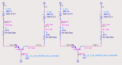

rfss_v2_4_lib_bfu630f_mex_schematic和rfss_v2_4_lib_bfu630f_spice_schematic的区别是什么
150件の閲覧回数
Zhengjiang_Zhao
bfu630三极管有两种仿真模型,他们的仿真结果有一点不同,这两种仿真模型的区别是什么
120件の閲覧回数
ErikaC
MEXTRAM model is expected to be more reliable than the SPICE.
You will find more information here:
https://www.iee.et.tu-dresden.de/iee/eb/forsch/AK-Bipo/2015/AKB2015_26_NXP_Willemsen.pdf
Regards.
