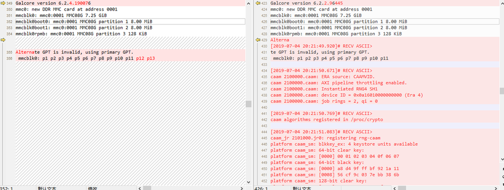

zhangmike
Hi Wigros:
    Thank you to support some information for me.  But I have some questions.  Kernel is running failed only,  and android doesn't init.
and I compared the booting log with normal booting log of android N. I find caam doesn't run in android P booting log. what is caam?
left: kernel booting log in android P                                                                right: normal kernel booting log in android N
Thanks!
zhang mike

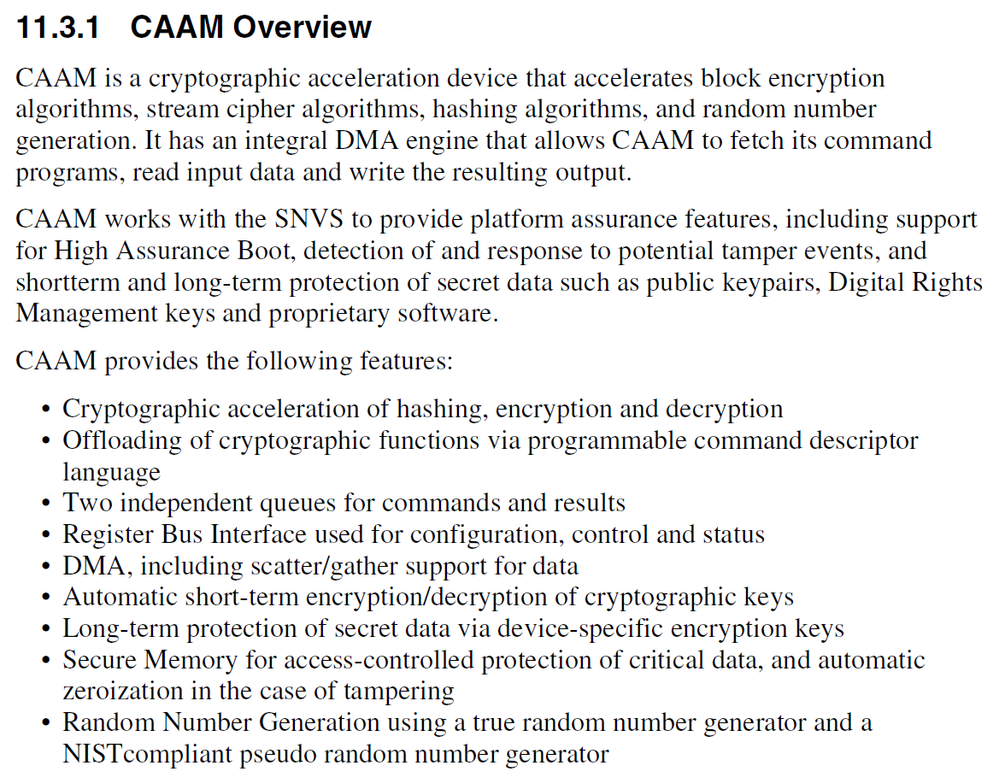

weidong_sun
Hi Mike,
    CAAM is "Cryptographic Acceleration and Assurance Module", which is described in reference manual like below:
Have a nice day!
BR,
Weidong
