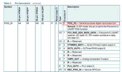

hello iam using lpc55s16 "How can I use the USART RX pin as an IO pin?"
1,994 Views
Harry_Zhang
Hi @syedhashmiraza
If your USART RX pin is PIO0_29.
You can refer to the LPC55S1x/LPC551x Product data sheet.
You can change function of PIO0_29 to 0 function.

Harry_Zhang
Hi @syedhashmiraza
As I mentioned in my previous post, you need to change function of PIO0_29 to 0 function.
0 function is the IO function.
You can import the USRAT example form LPC55s16 SDK.
In pin_mux.c, you can change the code
