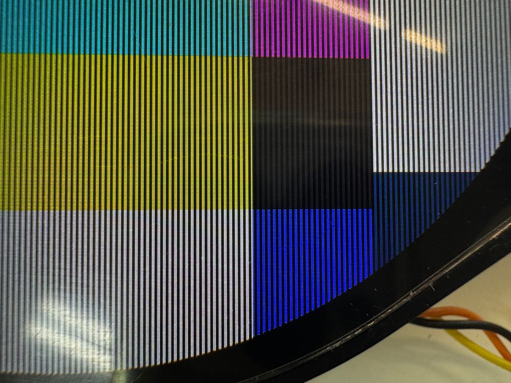

Hi @Chavira ,
I removed all the resistors and checked the connector connections; now the display shows images. However, there is a strange error across all views: the display shows two lines on and two lines off. I tried changing the number of lanes from 2 to 3 and adjusting the clock frequency, but the issue persists. Please see the attached image.
Could this be related to incorrect wire impedance? There are also some other artifacts, especially on white color bar, but I believe they all originate from the same problem
Thank you,
Paolo

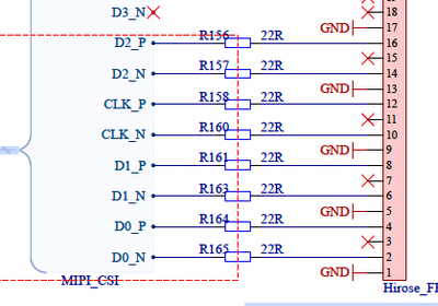

Hi, thank you for your quick reply.Are you referring to the series resistance?
Also, my hardware designer placed a 22Ω series resistor on all lanes and the clock signal.
I will try removing all of them
thank you

Paolo3C
I’m using a custom board.
The hardware designer placed a 22Ω resistor in series on all lanes and the clock signal.
Could this be the problem?

Paolo3C
I removed all resistors, but nothing change, the 2 mipi dsi lanes are ok, the clock is not present.
I never seen the display active. If I stop Weston service and run modetest I can see the pattern of data on all lanes but clock P and N remain at 200mV.
