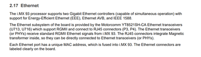

I have a follow-up question regarding the MAC address for the i.MX93 FRDM board.
From the i.MX93 FRDM datasheet (screenshot attached below), it is mentioned that:
Question is : Is there any physical setup on the i.MX93 board to configure or set a static MAC address for every bootup, or is the MAC address always fused and fixed inside the i.MX93 processor?
1,187件の閲覧回数
danielchen
Please refer to below link to write MAC address.
Solved: i.MX91 fusemap spreadsheet needed to write MAC addresses into OTP - NXP Community
