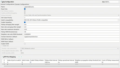

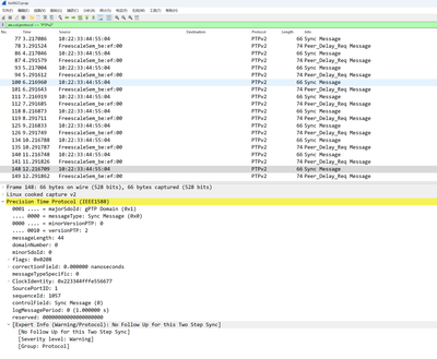

Configuring sja1110 as grand master or bridge, the master port (port 4)always sends only sync messages without follow up messages. Then the flag field of the sync message shows two step. I don't know why no follow up message was sent.
The s32g pfe0 port as the slave port sends  pdelay req message, but the sja1110 port4 as the master port does not respond to the pdealy req message and sends a qdelay resp message.

After reviewing your project, everything I checked looks correct — including the source code and gPTP settings. However, I noticed that only one port is defined for gPTP. You might want to try enabling the "Pdelay Initiator" option for that port.

In this case, the captured packet only has sync but no follow up.

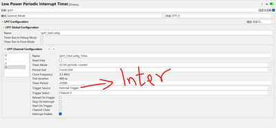

I found a mistake in the configuration, which was caused by my carelessness.
The trigger source of LPIT channel 3 should be changed to internal trigger.

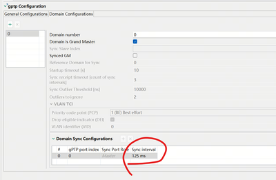

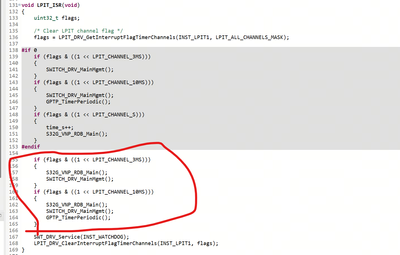

Other changes I made are:

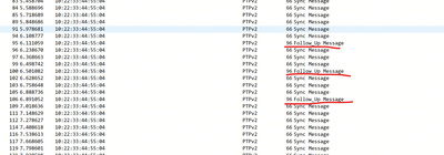

In this case, follow up messages are occasionally sent, but I don't know the reason.
The attachment is the captured package.
