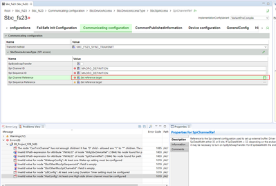

When upgrading the SBC-FS23 driver from V1.0.0 to V2.0.0 using the EB30.0.0 tool, an error message appeared stating that an SPI reference was not selected. However, the reference option was unavailable. Shouldn't the Chan ID and Seq ID be automatically associated based on the reference?
在使用EB30.0.0工具,将SBC-FS23驱动由V1.0.0升级为V2.0.0时,报错没有选择SPI参考,但是参考选项无法选取,Chan ID和Seq ID应该可以根据参考引用自动关联吧。

Thank you, but even after deleting and adding back the fs23-related modules, they are still not selectable.
谢谢,但是我删除掉fs23相关模块后再重新添加回来,还是不可选取:

The FS23 fields are not selectable because FS23 depends on a valid SPI configuration, not just on the FS23 module being present.
From the error list in the screenshot:
  • SpiChannel has no (or invalid) SpiJob
  • SpiJob is not linked to a valid SpiSequence
  • SpiSequence is empty or incorrectly configured
  • Some SPI timing/driver settings are missing
As long as any SPI error exists, the ECUC editor blocks SpiChannelRef and SpiSequenceRef selection in FS23.
What to do (in order):
  1. Configure SpiChannel → SpiJob → SpiSequence completely
  2. Make sure each sequence contains at least one job
  3. Resolve all SPI-related errors in Problems View
  4. Regenerate ECU configuration
Once the SPI module is error‑free, the FS23 SPI references become selectable automatically.

I'm answering you using a different account. The previous account frequently experienced lag when logging in and obtaining the verification code. After upgrading selected module configurations and verifying selected projects, the Error Log showed an error: "SPI was not selected for FS23," but it's actually not selectable. Then I deleted the FS23-related modules, and verified the selected projects and generated the project again. The Error Log no longer showed an error, and the project was generated successfully. Below is the SPI configuration.
我在登陆另一个账户来回答你,上一个账户经常在登陆获取验证码时卡顿。
在Upgrade selected module configurations后Verify selected projects会在Error Log显示报错:FS23的没有选择SPI,但实际上不可选取。
然后我删除掉FS23相关的模块,再次Verify selected projects和Generate Project,Error Log没有显示报错且能正常生成。以下是SPI的配置:
Finally, I manually added the FS23-related modules, but Verifying selected projects still showed an error in the Error Log: FS23 did not select SPI and was still unselectable.
最后我手动添加FS23相关的模块,Verify selected projects依然会在Error Log显示报错:FS23的没有选择SPI,并且依旧不可选取。

this looks like a dependency conflict. SPI exists, but SPI is not selectable anymore, because it is already “owned” by the generic SPI module configuration. Please try following:
Let FS23 create SPI:
  1. Remove FS23 modules
  2. Remove SPI module
  3. Add FS23 modules first
  4. Enable/configure SPI inside FS23
  5. Let the tool auto‑generate SPI, jobs, and sequences
  6. Verify selected projects → OK
