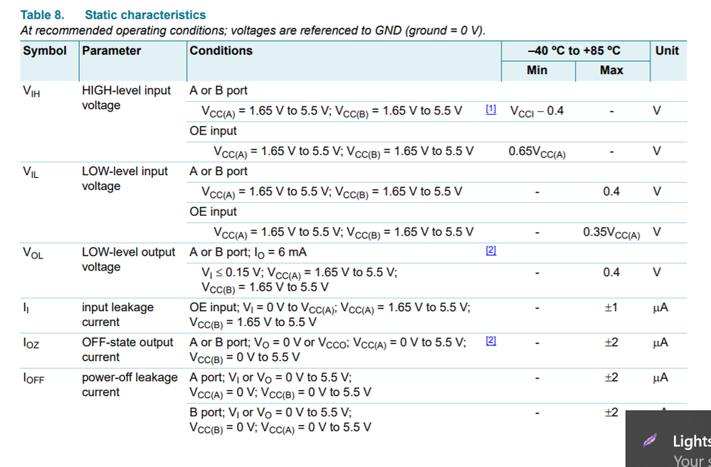

In the case of one NTSX2102 on the I2C bus, VOL is about 200mV.
Maximum value of Vol is 400mV so anything between 0V to 400mV is correct for Vol. Please see the picture bellow.
In the case of two, VOL increases to about 400mV.
The 400mV is a boundary value. In some cases might be ok in other the value might easily increase and cross the 400mV. The I/O pins are open drain. To be on safe side, try to increase values of the pull-up resistors. It should help and lower the Vol.

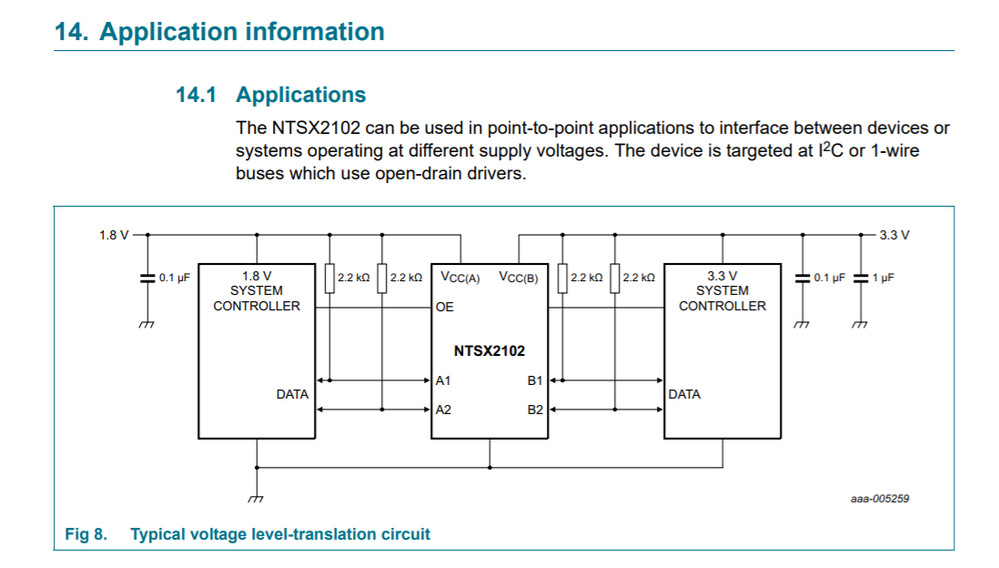

The NTSX2102 is designed for one system controller on each side. Please see picture bellow for typical application. If you connect more devices on one or both sides it can do some mess up.
Is it not recommended to connect multiple NTSX2102s on the same bus?

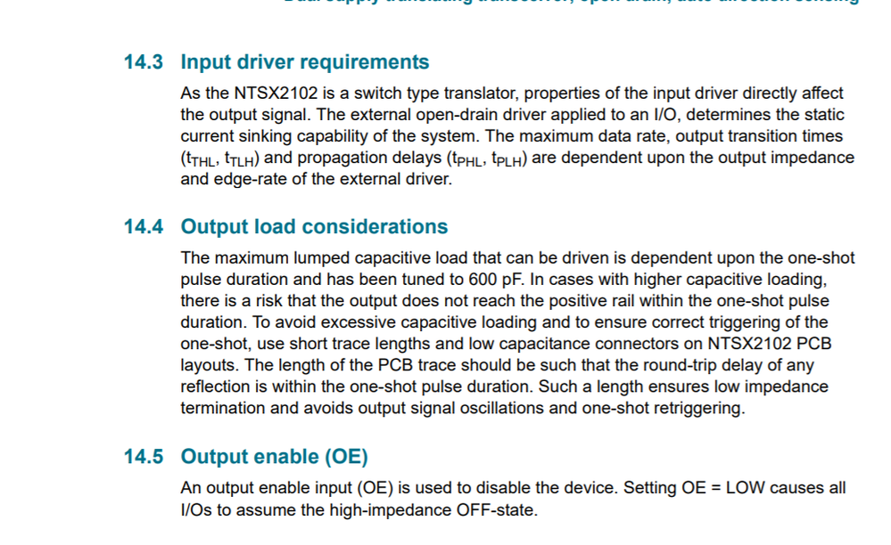

It is recommended to connect only one device on each side. Please see the picture above. If you connect more devices on one or both sides it could exceed maximum output load. Please see bellow.
