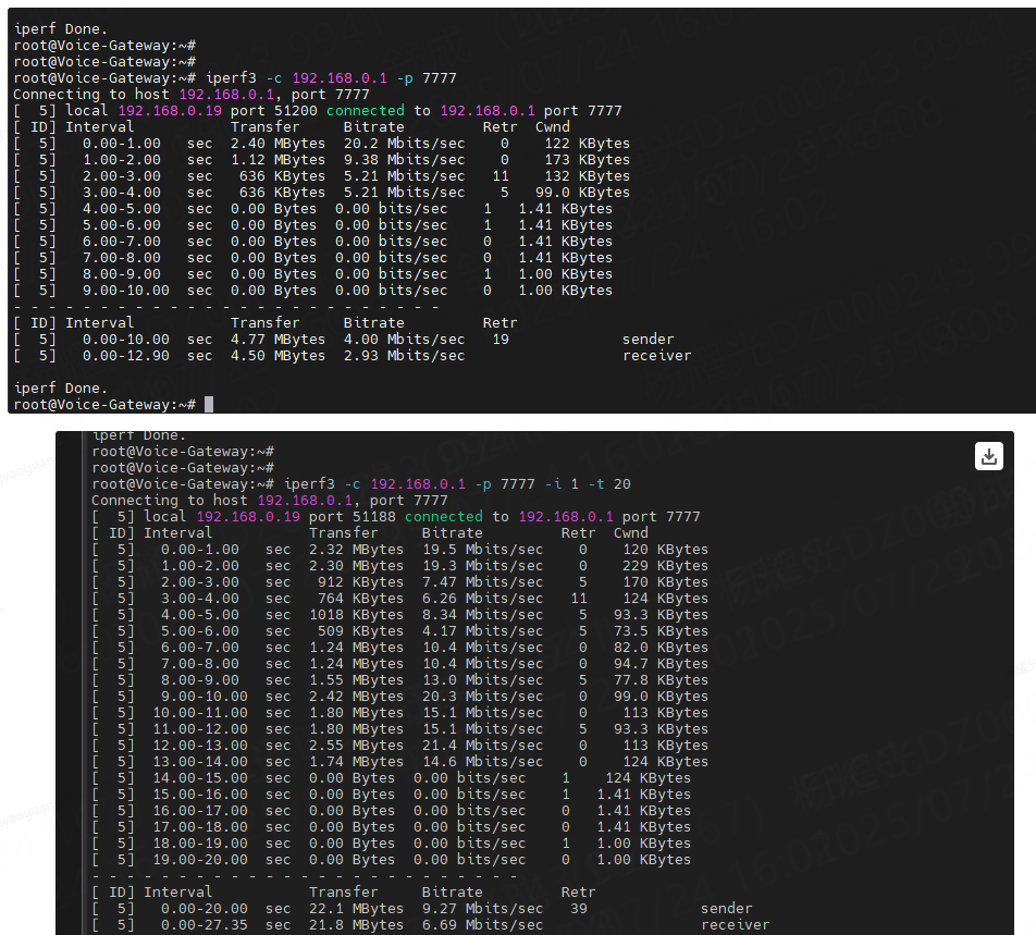

We are currently evaluating the performance of the NXP SD8997 WiFi module (SDIO interface) on an i.MX6ULL-based platform running Linux 5.4.24, using the official moal/mlan driver stack. The firmware in use is sdiouart8997_combo_v4.bin, version 16.92.21.p84.4 (FP92), along with the associated tx_power_test.bin power table. Firmware loads correctly, and the driver reports successful initialization without errors.
However, we are encountering a critical and reproducible issue: when operating in 5GHz STA mode, the WiFi throughput frequently drops to 0 Mbps during iperf3 testing, even in stable open-air environments. This issue significantly impacts our validation process and raises concerns about the module’s reliability in real-world deployments.
In our test setup, the SD8997 module connects as a station to a 5GHz AP (HT40, channel 161). We initiate standard iperf3 throughput tests (e.g., iperf3 -c <AP IP> -t 20 -i 1 -P 10), during which multiple threads consistently show zero throughput, despite minimal retransmissions. Disabling power save features (ps_mode=0, auto_ds=0) does not alleviate the issue. Firmware initialization and WLAN association complete successfully, and the interface transitions into the CONNECTED state normally. The problem begins only after traffic starts flowing.
This issue is currently blocking our development progress, as 5GHz STA stability is a critical requirement in our target application.
We kindly seek your urgent support on the following:
  1. Is this a known issue with firmware version 16.92.21.p84.4 (FP92)?
  2. What is the recommended firmware and driver pairing for Linux 5.4 platforms using the moal stack?
  3. Are there known firmware-level limitations in STA mode that may cause Tx path stall or data flow blockage?
  4. Is there any debug firmware, patch, or recommended workaround available to help isolate or resolve the issue?
We are happy to provide additional test data, full dmesg logs, configuration files, or conduct further diagnostic testing as needed.
Thank you very much for your time and support. We sincerely appreciate your assistance in helping us move forward.

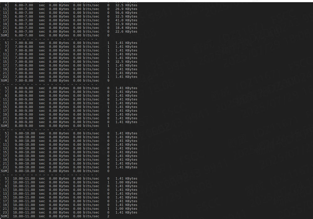

      • Client: iperf3 -c <AP IP> -t 20 -i 1 -P 10

After applying these updates, we reran our 5GHz STA performance tests using iperf3 with 10 parallel streams (-P 10). Unfortunately, the issue still persists — multiple iperf3 threads report 0.00 bits/sec throughput for prolonged periods, as shown in the attached log. This behavior occurs even in a stable test environment with minimal retransmissions and power-saving features disabled (ps_mode=0, auto_ds=0).
This pattern suggests a possible Tx path stall or queue starvation issue, potentially at the firmware or SDIO transport layer, despite successful association and initialization.

The attachment contains the full test log, including dmesg output, iperf3 throughput results, and Wi-Fi configuration details, with the driver loaded via modprobe moal mod_para=nxp/wifi_mod_para.conf.

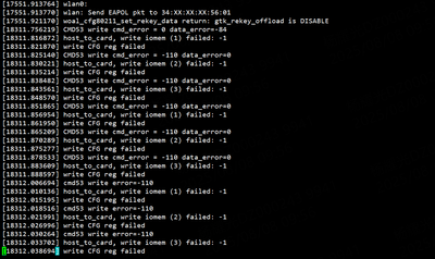

During ongoing stability and repeated reconnection testing, we’ve discovered a new problem:
After multiple EAPOL timeouts, the driver triggers an in-band reset, but the firmware then fails to reload via SDIO, leaving Wi-Fi in a non-functional state until reboot.
This issue seems to occur only after repeated connection failures. It may be related to how the firmware or SDIO interface handles recovery after in-band resets.
Here is the relevant dmesg log:
[87697.429777] WiFi Reset due to EAPOL timeout cnt 5
[87697.499968] ========START IN-BAND RESET===========
[87704.130302] wlan_sdio_poll_card_status failed, tries = 10000, cs = 0xc
[87704.259872] wlan_dnld_fw fail ret=0xffffffff
[87705.481337] woal_request_fw failed
[87705.484769] Firmware Init Failed
Could you please confirm whether this is a known issue, and if there is any workaround or firmware update available?
Thanks again for your support.
