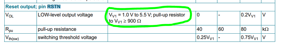

Q1:If a pull-up resistor is added to the RSTN pin of UJA1169, what is the minimum resistance value?

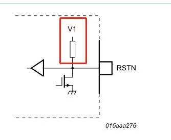

Q2:Can you provide the MOS tube parameters below V1 in the figure? How much current can it resist?

Please see below comment:
1: 900OHm
2:V1 below 1V the MOSFET is OFF, the estimation value is about 4mA.
