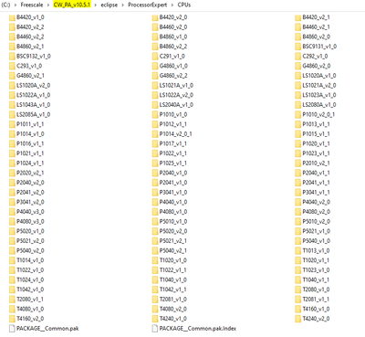

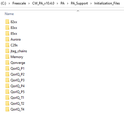

When the Code warrior tool is installed, the MPC8640 is not found in CW versions v10.4.0, v10.5.1. Please let us know if we need to enable any additional patches/updates. Shared the snapshots of processors of both versions.
3,180件の閲覧回数
Oswalag
It is because MPC864X is not supported by Code Warrior for Power Architecture IDE, it is supported in CodeWarrior 8.8 (IDE 5.9).
