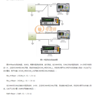

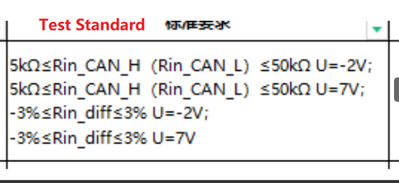

       I  am doing the CAN Network Port Resistance test and found it did not meet the test standard, show as below
and the test circuit and method are as below
anyone can tell me why it is like this? and how to make it to meet the test standard? thanks a lot~

麻烦我想知道您测试的这个参数是不是对应datasheet下面的?
1,550件の閲覧回数
Fidel
不是的,是甲方客户的测试标准,不过应该也是通用的测试标准。
1,548件の閲覧回数
guoweisun
他是想测试哪个参数?
1,544件の閲覧回数
Fidel
这些参数Rin_CAN_H/L 和Rin_diff,具体计算方法也应该就是最开始贴的那张图里的
