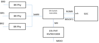

Hello NXP,
I am working on adding a SJA1105Q Ethernet switch to Renesas SOC. kernel crash has been observed after loading the sja1105.ko file into the kerne. steps and kernel crash logs are shown below.
  1. Added the dependent modules first.
    1. dsa_core.ko
    2. ptp.ko
    3. tag_8021q.ko
  2. Load sja1105q.ko module and check the dmesg logs for faults.
  3. Kernel crash has been observed

The device connectivity and the DTS details are shown below.
Device connectivity:
Device tree configuration:

Please review the configuration and kindly help to fix the kernel crash.

Hi Jayasankar,
Thanks for your message and sorry for the delay.
Unfortunately, I see multiple things are wrong, let me try to list them:
1. port@0 -> phy-handle = <&phy0> (dummy_phy): please remove that.
No such thing as dummy phy, and worse, it is invalid to have both a phy-handle and a fixed-link for an ethernet port. So either one or the other.
2. sja1105,role-phy: can be removed (doesn't affect functionality)
3. compatible = "microchip,ksz9031":
Ethernet PHYs, if they have a compatible string at all, should have it in the "ethernet-phy-idXXXX.XXXX" form, which is all that is recognized by of_mdiobus_child_is_phy() as a phy_device. If it's not recognized as a phy_device, it will just be a raw mdio_device
4. same comment for compatible = "marvell,mv88q2112"
5. To get more information about where it hangs progress can be made by disassembling the kernel object file and seeing what is at the line where it crashes.
The technique would be:
  • From the console where the kernel is built (and using the same toolchain that was used to build the running kernel), run: "make drivers/net/dsa/sja1105/sja1105_main.lst"
  • This creates the listing file which intertwines the disassembly with the C code
  • Open that file, find the offset of the sja1105_probe() function
  • Show us what code is around that offset of sja1105_probe() + 0x130 byte

Hello Sabeur,
Thanks for the information. Infact I realizsed and changed the device tree nodes. But still issue in connecting/attaching (of_phy_attach) PHY device node in of_mdio.c file.
Updated DTS file is,

In order to first test the PHY device, I just enabled only one switch port. I just commented the compatible property for mii_eth_phy3 PHY.

Jayasankar
Hello Sabeur,
Could you please tell me which kernel modules required to me selected for the connection diagram attached here with.
Thanks and Regards,
Jay
10,932 Views
Sabeur
HI,
Which diagram ?
10,905 Views
Jayasankar
Hi Sabeur,
Attached the picture.
Jay
10,891 Views
Sabeur
Unfortunately it is not specific to be able to help however, I can suggest a method:
search for all compatible strings from the device tree in the "drivers/" folder, see where the driver lives, open the Makefile for that driver, and enable the Kconfig option that controls the compilation of that file.
Sabeur

What could be wrong in here ? any guesses ?
